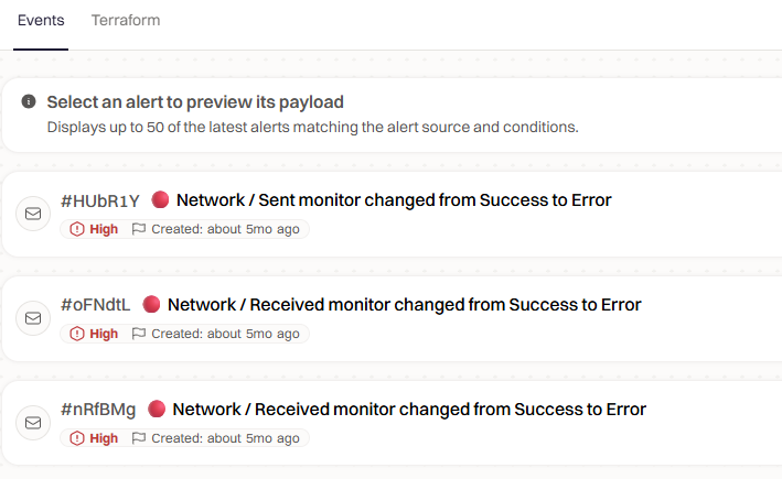

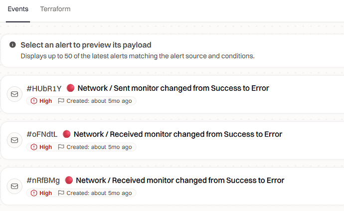

Go to your alert source in Rootly and open the Events tab.

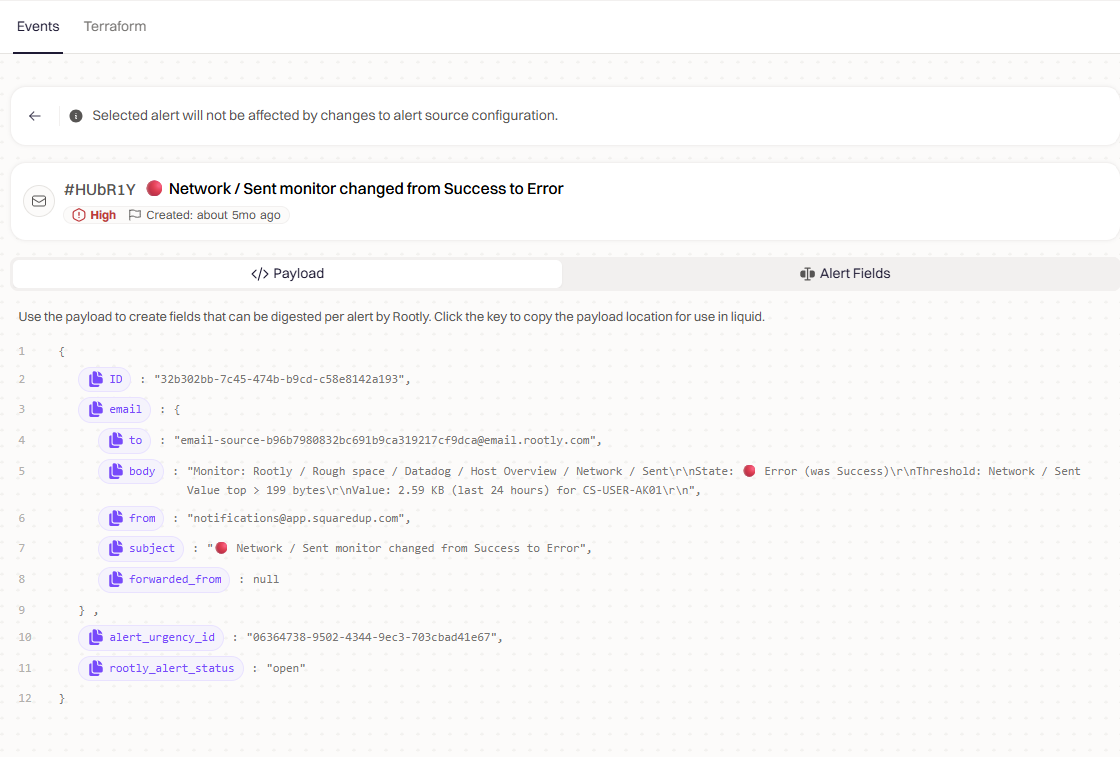

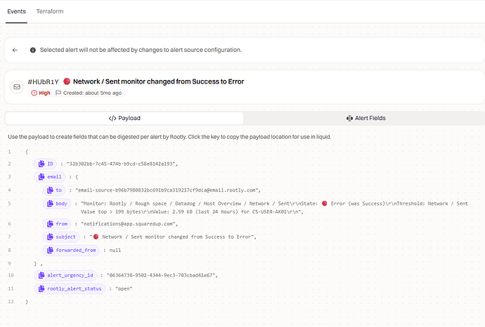

On the right side, open an existing SquaredUp alert in Rootly and check the Payload tab to configure it.
For example, when I open the alert, here is the payload:

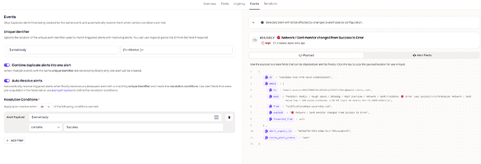

Setting auto-resolve config

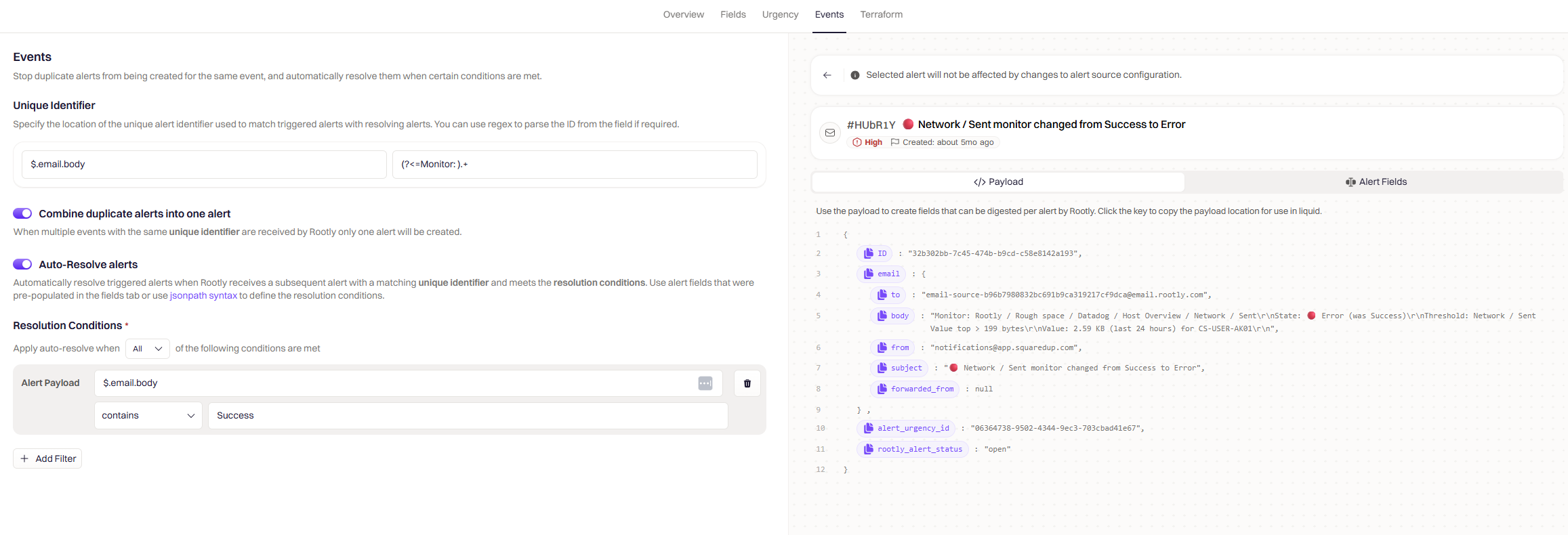

There are 3 things to set up here:
1. Unique Identifier
Set the JSONPath to $.email.body and the regex to: (?<=Monitor: ).+
This extracts the monitor name from the body, which stays the same across both the firing and recovery payloads. Rootly uses this to link them together.
2. Combine duplicate alerts
Turn this on so multiple firing payloads for the same monitor don’t stack up as separate alerts.
3. Auto-Resolve alerts
Turn this on and set the condition:
JSONPath : $.email.body
Condition : contains
Value : Success
When a recovery payload comes in with a matching monitor name and that condition is met, Rootly will automatically close the open alert.
Here’s how the configuration looks:
