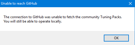

Hi Everyone,
I have imported into our SCOM 2019 UR2 (console says 10.19.10407.0) instance Cookdown.EasyTune-2.0.1.0
Step 1 states “Tuning packs contains recommended tuning for one or more MPs”
However, there are no MPs showing in the Tuning Packs window.
Am I missing something here?
Thanks.
Hi Steve,
Are you behind a firewall, proxy, etc.? Sounds a little bit like it can’t connect out to the repository. You might have to get an exception put in if so. It goes off to the raw version of GitHub - cookdown/easytune_overrides: This repository contains the community provided Tuning Packs for Easy Tune via a rebranding link.
Otherwise you can set yourself a fileshare or something like that as your custom store, clone down the repository, and then run a small script to convert it into the correct format. There’s a support article on that here.
Yes, Server is behind a firewall with no outbound connectivity.
Offline method now shows my Custom Store using the CustomStoreFormat (as CSV/json)
