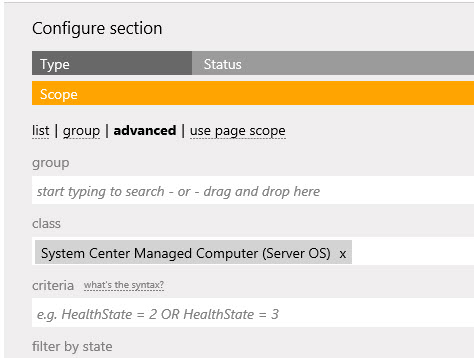

My status dashboard scope is All Windows Computers (which right now lists all the servers besides the new ones I just added).
update - if I change the scope to Windows Server 2012 R2 Full Computer Group then I see the new servers. However I have some 2008 servers as well which I want to see at the same time as the 2012 servers. So the question is why do some server 2012 R2 servers show up in the scope of All Windows Computers and some do not? The other question is can I create a custom group in SCOM to house all 2008 R2 servers AND 2012 R2 servers?
If you view the members of the All Windows Computers group in SCOM, do the new servers show up there? It looks like that group is dynamically populated by the System Center Managed Computer class. Have you tried to use that instead of the group in your scope?
So I checked All Windows Computers group in SCOM and did not see the new servers listed, however when I used the System Center Managed Computer (Server OS) scope, they showed up! Thank you!
