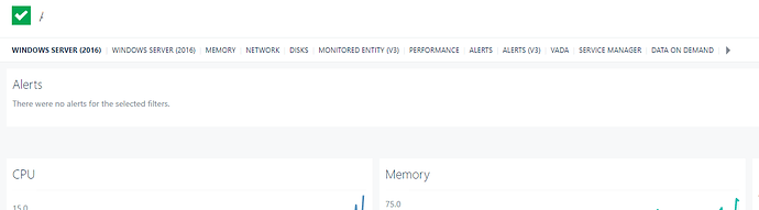

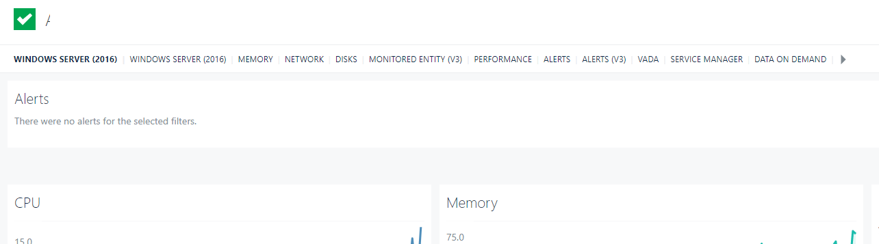

When I go to look into a server, such as from search I enter a server name then choose the Windows Server 2016 Computer (full) choice. I am then presented with the perspectives for the server. For servers with IIS 7/8, I see an IIS perspective, however the perspective does not show for IIS 10 servers.
As far as the group is considered, the group is populated and viewable within squaredup.
However to your point regarding the IIS computer group, the IIS 10 devices are not shown within the group. hmmm
For our resolution - we duplicated the perspective then edited the json to specify the IIS 10 Computer Group.
Although we were unable to choose the IIS 10 Computer Group from the GUI, editing the JSON to the Group ID was a success.
