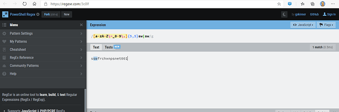

I have been playing around with these also to see if it could fetch a switch (to confirm that part works)
[a-zA-Z-_0-9.]{5,5}sw|sw – ( just setting sw|sw instead of sw|SW)
